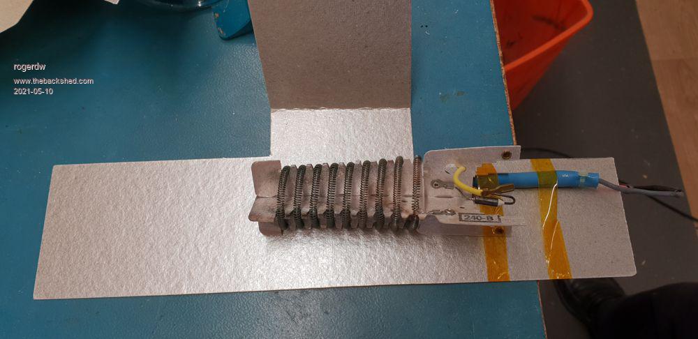

Tony had suggested I need to do an equivalent power test and I had been dragging my feet because I wasn't sure if I'd be able to work out how to do it successfully.

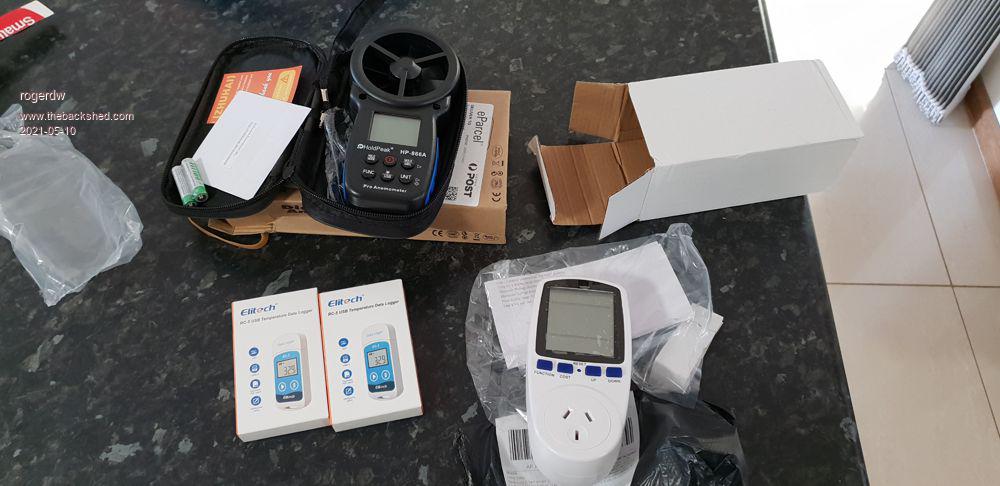

My other test gear hasn't arrived yet, but on fri I pulled apart a heatgun and pinched the element. I then mounted that on a piece of insulating material.
I lengthened the heater outlet tube by ~600mm and shoved the heater a fair way down  ...  noted the output temperature  ...
...  then I powered up the element via a variac until the temperature doubled.
The heatgun is a 1,200 watt 240v unit  ...  5 amps  ...  so the element should be 48 ohms, which it is!
My first test was on Fri at 12:10pm, ambient was 25 though we had probably 90% cloud cover.
The heater outlet was 33.3  ...  so I needed to get to 66.6  ...  which I did fairly easily at 100.2v.
Of course power = V squared/R = 208 watts!

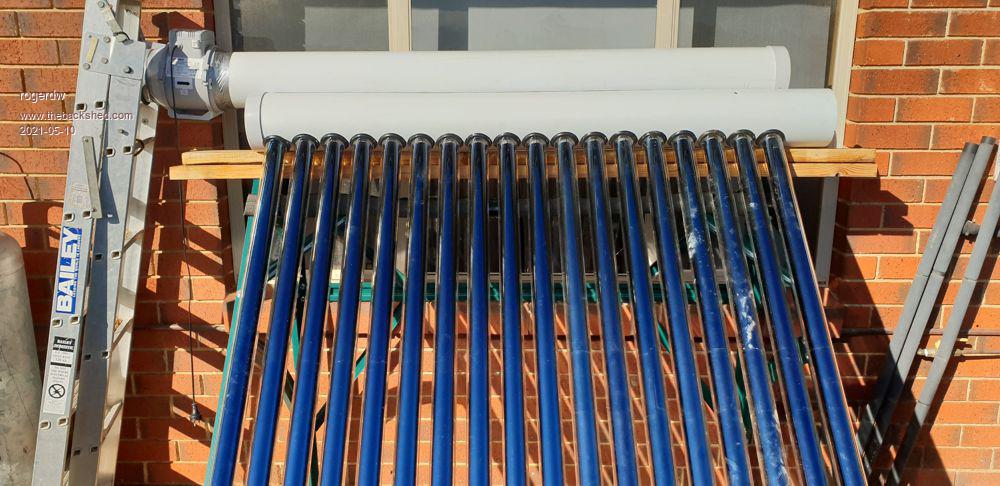

I'm not sure what I was expecting, but the 6 tubes cover an area less than one 250 watt solar panel  ...  and I'm pretty sure under the conditions one of those would have had virtually no output  ...  so I have to be happy with what I've got.
I always envisioned a heater needing perhaps two lots of 18 tubes  ...  but that is still only perhaps 1,200 watts.
Anyway, I had committed to build an 18 tube heater, so that's what I'm working on now.

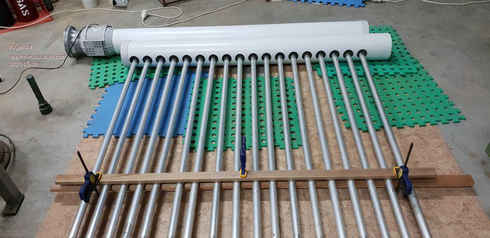

I have all the bits organised and ready to put together  ...  I just need to work out how to lift my 25 kg assembly couple meters in the air and slide the 18 tubes down into the glass tubes at a 45 degree angle!!!
This is the heatgun element taped to some insulating material, which I powered up with a variac

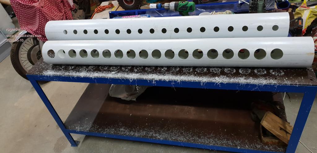

Lots of use for my holesaw kit, at this rate I'm gunna wear it out. It sure is a pain prising the cutouts out of the saw though!
This tubing is 150mm and cost me $10 from the junkyard  ...  but two endcaps cost me $10 each from Bunnings.
I stuck some wide weatherproofing foam across the holes between the two tubes and then used a smaller diameter holepunch to cut the holes.
I bolted the tubes together, slid the tubes in and fed a wire through holes in the top of each tube so they can't slide out and drop to the bottom of the evacuated tubes like did happen with my first experiment.
That was a pain trying to line up the holes, but it worked in the end.
Oh, I forgot to mention  ...  the tubes only cost me $2 each  ...  but they were only 1,400mm  ...  so I welded 400mm onto each one.
I've never welded aluminium before and I did a really crap job. I started with the oxy, some proper flux and rods  ...  eventually gave up in disgust.
Then I tried the TIG and that was far worse, so I went back to the oxy. They'll have to do.

I bought a few of those aluminium brazing rods from e-bay to try after watching a demo on you-tube. Very impressive, but it needs nice clean bright shiny aluminium to work well.
If the aluminium is old and oxidized and pitted, those brazing rods are pretty hopeless even after trying to get a clean surface.
If you are buying fresh brand new aluminium parts, its an ideal way to make nice strong leak free joints with thin material.  It works on thick material too, but its very slow and uses heaps of propane because the heat really spreads.
TIG + argon is far better and much faster for heavy aluminium parts.
The aluminium is in great condition and using the scotchbrite belt on the multitool makes it nice and shiny.
I think TIG is going to be out of the scope of my abilities  ...  at least without getting some lessons.
Okay, well my wife came home from her ambo nightshift, so I convinced her to help put this device together before she had a shower to go off to her main job. We carried it up the ladders and got our daughter to line up the pipes.
It had rained overnight and when we picked it up, the first thing that happened was a bucketful of water ran out the pipe, down my wife's sleeve to her armpit and soaked her ...  whoops.    Lucky she's a good sport.
Anyway, got it together and with the sun already out could see the temp climbing nicely.
Hooked up the fan and taped it on  ...  probably the first time ever in my life using duct tape to actually tape a duct!!!
I added an extra 3 ft of duct to the outlet and used my element to check power level.
This time the power was 752 watts  ...  which is pretty consistant with what I'd been getting earlier  ...
...  though I am still not sure if the IR device is a good idea for air temperature because I'm not sure if the localised heat from the elemment is not being picked up, despite my shielding. A proper temperature gauge might be a bit more accurate.
I just came in to regroup and have a coffee  ...  and the postie had just dropped off several eBay items  ...  an anemometer, a power meter and a couple datalogging temperature gauges. Now I should be able to monitor things a little better.

Its always handy to have equipment to be able to measure things, and the Chinese stuff is very cheap for what it can do.
