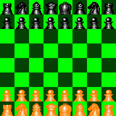

Hi Martin,
These are beautiful, but since I am running the graphics in VGA mode 1, I can only use  solid pieces, otherwise the board field color shines through.
I will scale the sprites when it becomes an issue. I think the board fields are 48x48 to line up with the 8x12 mode 1 color tiles. And the current set of sprites I have are 40x40 or so.
When I would use the 2350 I could use a different VGA mode (3), and get rid of the color tiles.

  Volhout said  Hi Martin,
Hi Harm,
Of course you are right. In my example the Spritesize is 48 by 48 so we have per sprite 6 tiles wide and 4 tiles high.
I can try to adjust the sprites so that the BG-colour changes only affect the outer area tiles of the figure (like the ZX Spectrum used to)
I'll give that a try
Martin

Here the sprites are adapted to the edges of the tiles, each sprite is 48x48 pixels, i.e. 6 tiles wide and 4 tiles high. The highlights can, as they are on other tiles, be set independently of the colour of the playing field
enlarged here for clarity
so, in Mode1 it could look like this:
Edited 2024-11-15 02:13 by Martin H.

Looks nice, the queen is a bit out of scale. How high is the actual piece? In case it is 36 pix, you can use a trick to place it in the centre of the field, and offset the playfield 6 pixels down.
Martin H.
Joined: 04/06/2022
Posts: 1570
Posted: 05:38pm 14 Nov 2024
  Volhout said  Looks nice, the queen is a bit out of scale. How high is the actual piece? In case it is 36 pix, you can use a trick to place it in the centre of the field, and offset the playfield 6 pixels down.
  Martin H. said   each sprite is 48x48 pixels, i.e. 6 tiles wide and 4 tiles high. The highlights can, as they are on other tiles, be set independently of the colour of the playing field
no, sadley they couldn't be moved pixelwise, the appearance depends on their position on the tiles
