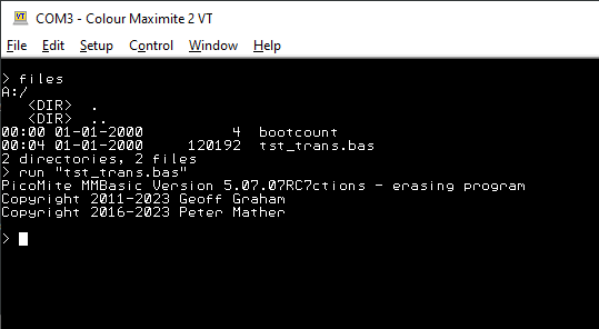

Posted: 05:27pm 25 Apr 2023
Hi Peter,
Now running RC7, it prints the message about there being too many sub/funs, but then it restarts, backing up one line before printing the (c) message and half erasing the error message from the user:
Edited 2023-04-26 03:28 by thwill

Posts: 12040
Posted: 05:40pm 25 Apr 2023
Just need to add a crlf but the concept works as I intended
The drive thing is me trying to satisfy your b: without a /
will fix
Edited 2023-04-26 03:51 by matherp
