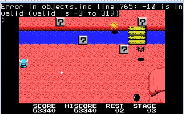

Another crash.
I have not been able to replicate the sprite like artefacts yet. Noticed that the arrows that those other knight things are firing are pointing the wrong way now, I don't think they were before.

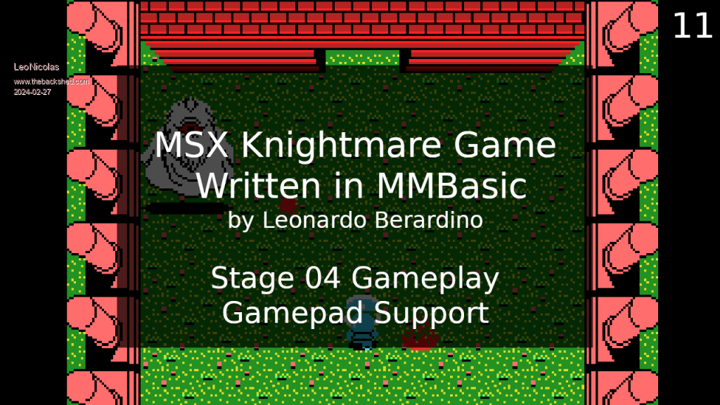

New video released: https://youtu.be/OcjvFrNt5Hg
News:
- Stage 4
- Support for gamepads
- Bug fixes

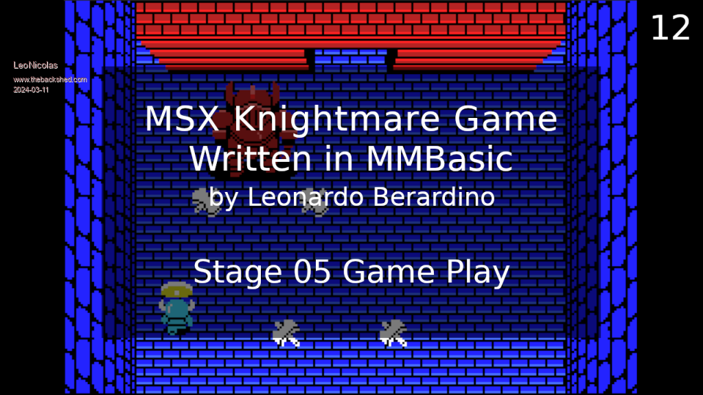

Stage 5 gameplay
there is a bug in the final boss implementation that I will fix today. It is not allowing to the defeat it.
https://youtu.be/in6Or0CSGJE

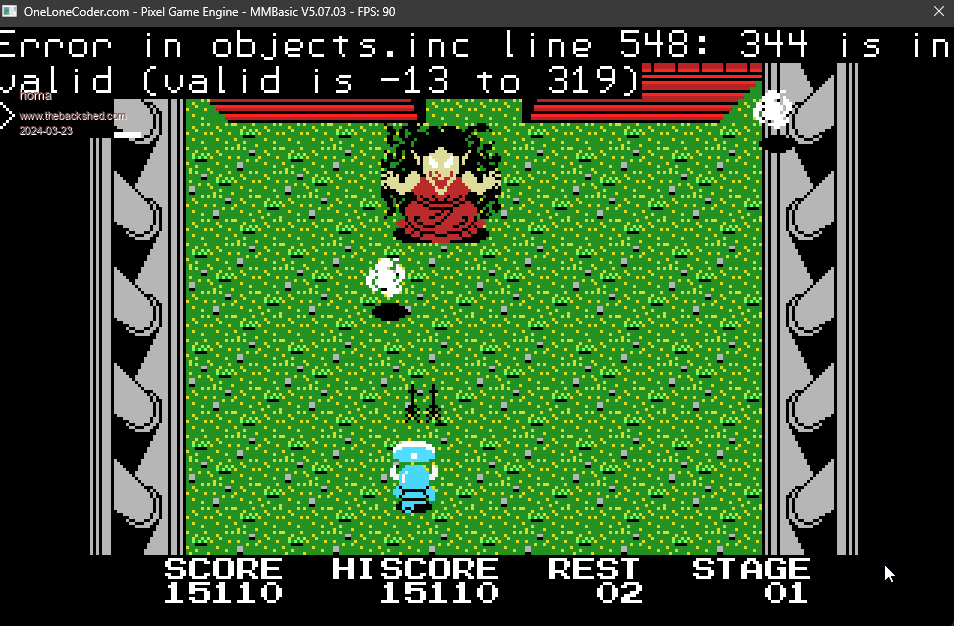

I tried out your game again. Status today from github. Because of error messages I had to comment out line 25 in init.inc for the specified MMBasic version:
' gamepad on handle_gamepad
and
in the file "km.bas" in line 157 directly after the
sub process_gamepad()
insert an "exit sub"
Today the keyboard control worked but unfortunately no collision. So unfortunately you are invulnerable.
Nevertheless the gameplay is fun!
However, I received the following error message for the final boss:
continued success!
Matthias
LeoNicolas
Joined: 07/10/2020
Posts: 625
Posted: 03:47am 23 Mar 2024
Hello Matthias
Thank you for testing the game. You need to download the latest MMB4W version to get support for gamepads. Check out this post:
https://www.thebackshed.com/forum/ViewTopic.php?FID=16&TID=16531
I didn't implement the player collision against shots and enemies because it makes the game easier to test. I will try to do it for the next version and add a flag to disable the collision.
I will look at the error you reported. Sometimes, I introduce errors in the early stages when implementing new ones. This error is probably related to some update I did while implementing the stage 5 boss.
