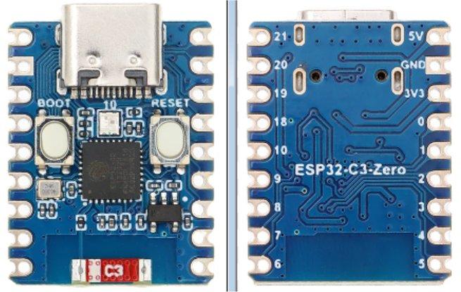

Posted: 02:51pm 04 May 2024
Here's another "Recent Basic", Annex32 on an 18-pin ESP32-C3-Zero.
Annex ESP32-C3-Zero .010    .080    .151    .153    .186    .277    .506    .299
Pretty comparable to the F4.

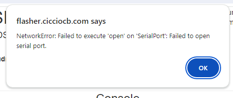

Posted: 02:41pm 08 May 2024
  JanVolk said   but I do have the LILYGO T-PicoC3.
That's what I have.
It's a no-go for me, thus far...tried every darned thing.
The COM-Port shows-up in the list but all I get is:
No response from the Annex32 guys.
Googled the message and tried everything including switching from a W11 to W10 system.
Downloaded the toolkit, the COM Port shows up on the list, attempt to flash and it complains that the COM port doesn't exist.
The USB-C connector is the correct orientation. I power-up, holding the Boot button so that all I have is a green LED. The COM Port even shows "J-Tag (something-or-other)"
Posted: 03:07pm 08 May 2024
  PhenixRising said  It's a no-go for me
I don't have that module, but have successfully flashed maybe 20 or more ESP32s using the web flasher--D1-Minis, S2-Minis, C3-Zeros, S2-Zeros.
Maybe it's a duff module (although I haven't had one yet).

Posted: 08:20pm 08 May 2024
PhenixRising ,
The LILYGO T-PicoC3 can be flashed in a somewhat strange way.
This module has an RP2040 with 4MB Flash and a 240x135 TFT screen and all other GP pins externally.
A reset button and a Boot button at the bottom. Furthermore, there is a UART connection (GP8-GP11) with the ESP32-C3 (GP4-GP7).
The ESP32-C3 with 4MB Flash and there is a UART connection (GP4-GP7) with RP2040 (GP8-GP11)
Also important for Flashing is that the USB-C can access the two microcontrollers separately by how the USB-C plug is placed in the module.
Blue LED then com port RP2040 and Green LED then com port ESP32-C3.
The RP2040 can be flashed in the usual way with Boot and Reset when the LED is blue.
The ESP32-C3 can be Flashed when the LED is green and with a link on GPIO9 to GND (Boot mode) and RUN(GP0) pulse to GND for reset ESP32-C3.
Now you can flash the ESP32-C3 with the online serial Flasher.
Chrome: WEB Installer   https://cicciocb.com/
Chrome:   https://flasher.cicciocb.com/dist/index.html
First make contact with the serial flasher and then reset pulse. Connect
Choose Connect and in the connection screen click on the line USB JTAG/Serial debug ........ Connect
The ESP32-C3 should now report.
Select Firmware CAN_USB_qio_LFS for an update only and choose everything the first time.
Choose Configuration (WiFi Name and WiFi Password otherwise AP mode 192.168.4.1)
Choose Program
Furthermore, it follows itself.
Suc6.
RP2040 sjabloon.pdf
Jan
PhenixRising
Joined: 07/11/2023
Posts: 2098
Posted: 08:50pm 08 May 2024
DOH! So the buttons are for the RP2040 but I need to use pins on the ESP32-C3. Yeah, thinking about it, would be dumb to share those buttons.
Many thanks, Jan (and Lizby)
