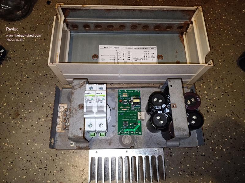

Posted: 07:56am 19 Apr 2022
A little progress, found an old Telecom 48V power supply, will use it to house all the parts for the hot water circuit board.
The capacitors will be ganged together and hopefully covered, so nothing can enter and get toasted.
The on/off switch will be cut into the cover on top and the heat sink will be at the back underneath.
I might even put an old analogue volt meter on the front just for something to look at.....If I can find it....it was on a bench somewhere.
