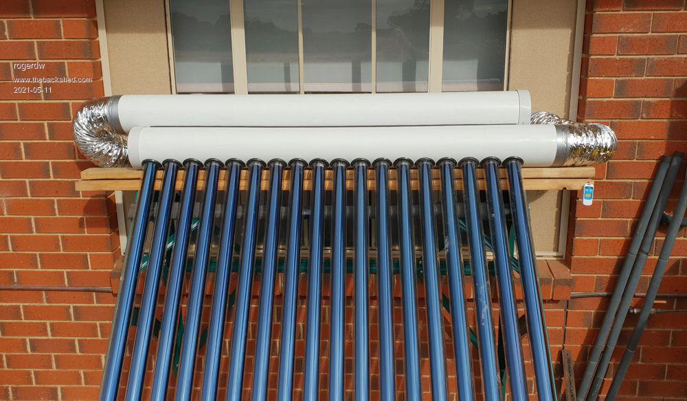

Okay, so I dragged one 250 watt panel out to that wall. What's the best way to measure it's power output  ...  you were mentioning large resistors the other day, I need to go see what values I have.
I should also mention that my evac tube array is only 1,415mm wide  ...  and two pv panels are 2,000mm wide. I'll give it a head start now that I'm getting a little more confident.
Today would have to be one of the best for testing because we go from rain to sunshine to wind, then lots of cloud and then back to the start. Almost a typical winters day except not quite as cold.
I set up the two dataloggers and set them to simply record at one minute intervals, the temperature at the inlet of the fan and the other in the outlet. Will be interesting to download that lot tonight and see what's happened.

Thanks. It's a bit rough but it came together reasonably well  ...  except for the welding, we won't talk about the welding.
I see your point about the lost space  ...  but it's only wasted while the sun is at 90 degrees. Most of the day the sun doesn't see a space between them because of the angle  ...
...  but I do have one trick up my sleeve  ...  with all the tubes and stands that I got, there was a set of three finely corrugated aluminium panels that I assume are meant to slide in behind the tubes to add some reflection.
Once I have some figures for the basic machine, I'll add them to the mix.

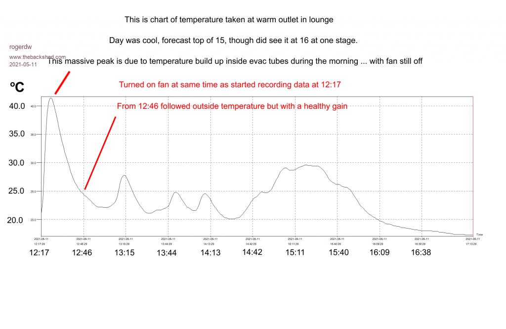

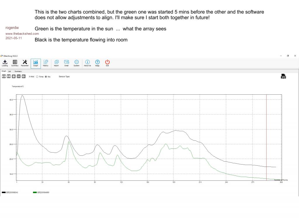

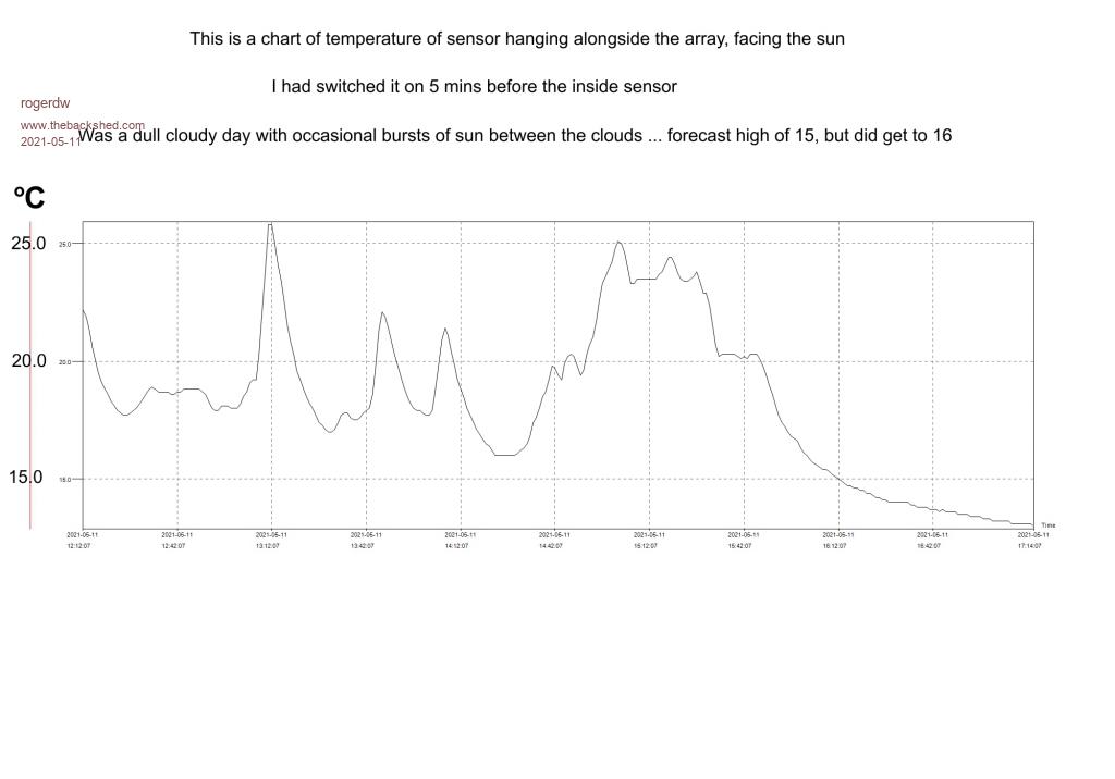

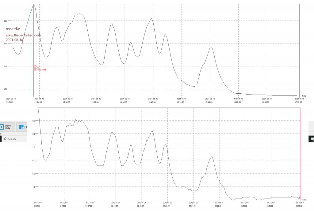

Well I have something to show you all.
Late morning I activated my datalogger devices and hooked them up to the inlet and outlet.
...  only I somehow didn't set the date and time on the second one so messsed it up.
I also only fitted the second one as an afterthought half an hour after the first.
I had to crib the second graph to try and match the times  ...  they both took readings a minute apart  ...  but the first one took 346 readings and the second 315.
And I haven't worked out how to add two outputs on the same graph, though will probably be easier when they have the same date and time scale.
The top graph is of the outlet temperature and the second of the inlet.
As I said earlier we had all four seasons several times over today  ...  so to see the outputs was particularly interesting.

Your graph is a bit hard for me to interpret. I can see a peak of 32oC but I do not have a practical understanding of airflow in that sense. As such it's not possible for me to relate it back to a power level I understand and can relate to.
If it's pushing like my inline fan does, that's worthwhile heating. If it's outputting like a 12V Bilge blower, meh, probably not going to do a lot.
I am ignorant  to which one it is however.

Another update for today.
I made up some inlets to connect the heater to the house  ...  to take inside air out into the tubes, add heat and then pour back into house.
Took a while to do and only set it going at 12:17.
You can see the outdoor sensor hanging on the timber at the right of the array, facing the sun.
One mistake I made was to switch the outside sensor on 5 mins before the indoor one.
I didn't realise the software doesn't allow you to adjust the timing to match up the charts  ...  so keep that in mind when you look at it.
The indoor sensor hung in the outlet of the hot air into the room.
Here's a shot of the setup with the ducting connected.
Cheers,  Roger

  Quote  Your graph is a bit hard for me to interpret. I can see a peak of 32oC but I do not have a practical understanding of airflow in that sense. As such it's not possible for me to relate it back to a power level I understand and can relate to.
Hopefully todays graphs are a bit more enlightening.
The fan is a Blauberg 150 US. Has an airflow of 560 cubic meters per hour using 50 watts on high  ...  and 430 cubic meters per hour using 42 watts.

The installed setup looks quite neat and professional.
Can see the graphs better as well as read them but the thing you never mentioned was how did you FEEL it worked?
Did you notice the area to which the air is being exhausted into warm up at all?
The numbers are great but at the end of the day, the comfort factor is the important one and that can't be measured with an instrument.
Couple of suggestions, I don't think you should have the logger in the sun and perhaps instead of inlet air, put the logger in the house and see if you can get an indication of how it's warming the place up.
That's really the important bit.

Haha, I'm trying to be the scientist here  ...  none of this touchy feely stuff  ...  just the facts, the numbers!
I have to say that burst of heat when I first turned on the fan was awesome  ...  pumping out 40 degree heat was amazing. I was expecting a good high burst because I hadn't had the fan on at all up to that point, so it had all morning to store plenty of energy  ...  and I wasn't disappointed.
No question the lounge was warming up. By the end of the day it was several degrees warmer. Reached 20 degrees in that half of the room  ...  but the house is all open  ...  so will take a few days of that to make a big difference I think.
I've never been keen on airconditioning where all you feel is a draught  ...  and this is a bit like that in that area  ...  but it was definitely warmer.
The noise from the fan would annoy me eventually  ...  I should have left it outside  where it was  ...  but I can put it back out there easily enough. In an ideal setup it would at least be in the ceiling.
It only reached 16 degrees here today, yet you can see the temperatures that were pumping in at times. They had to make a difference inside.
Tomorrow is supposed to be 18 with a bit of sun, so can't wait to see what that does  ...  especially if I turn it on from first thing, not just lunch time like today.

The outside logger is in the sun because I already know the ambient temperature  ...  and I wanted to see what the array was 'seeing' as far as sunlight goes.
I was quite surprised to see the temperature of that logger get to 25 a couple of times  ...  yet the ambient never went past 16.
The second logger is in the house  ...  in the hot air outlet (where it blows into the room) because I wanted to see the output from the machine and be able to compare it with the warmth outside.
Clearly it follows the warmth from the sun outside  ...  and mostly several degrees hotter again.
Measuring the temperature inside seems all over the place so far. I really need half a dozen loggers scattered around to try and see some pattern.
