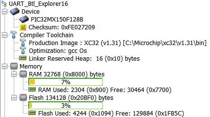

Posted: 10:09am 21 Jan 2014
I know a bootloader won't be used for space reasons but let's light some things:
I'm pretty sure that a serial bootloader from AN1388 will fit into 3Kb but unfortunately, not with the free version of XC32 compiler and not even with the unrestricted one, as there are some incompatibilities with the linker script and maybe other things (after all, it seems that the unrestricted compiler is pretty useless outside mpide environment). Here is the maximum I can get with xc32:
Obvious, the selected optimization level was ignored... I was directed to buy a different xc32 license
Anyway, the Microchip representative says:
[quote] The Maximite project is very interesting.
Let me bring this up to a few people and see what we can come up with.[/quote]
Hopefully, it is about the compiler...Edited by vasi 2014-01-22

Posted: 03:18pm 21 Jan 2014
Vasi, you can recompile your xc32 compiler from source and enable optimisation. I saw this on a site somewhere: http://jubatian.com/articles/turning-on-optimizations-in-mic rochips-xc32/
The legality of it is perhaps questionable but theoretically you are allowed to recompile a GPL application and use it, so perhaps it would be worth exploring.
AkashEdited by akashh 2014-01-23
