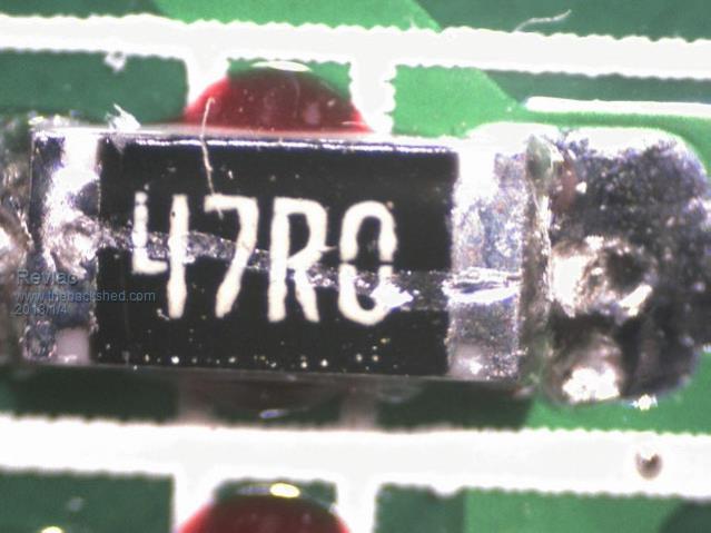

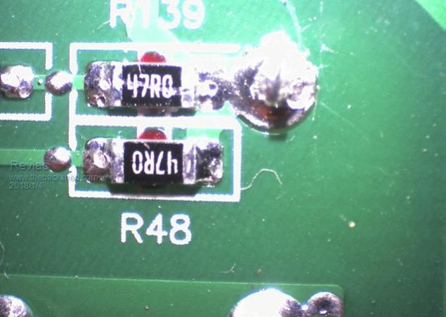

Some photo's with a usb microscope.
handy for finding suspect SMD joints and a shot resistors, There were 2 of them like this IGBT Gate drive resistors.
Could not see them with a magnifying glass

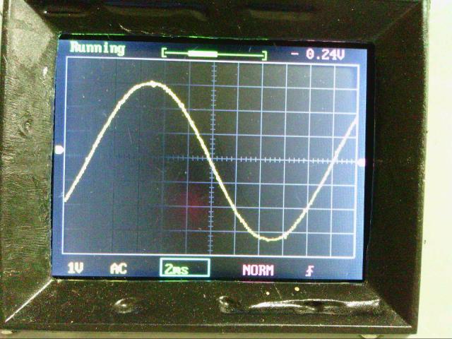

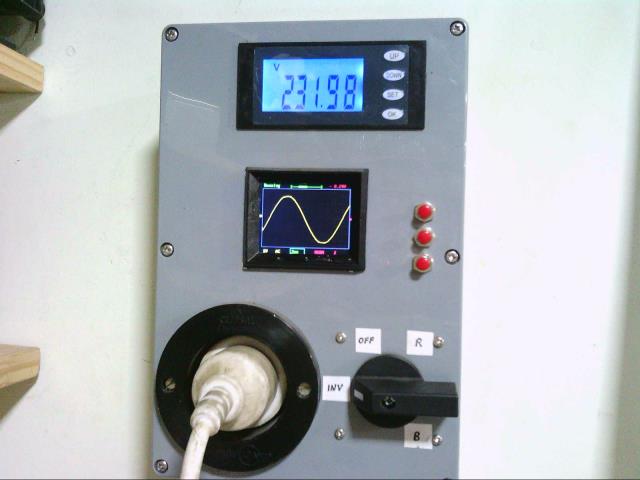

Here's mine.

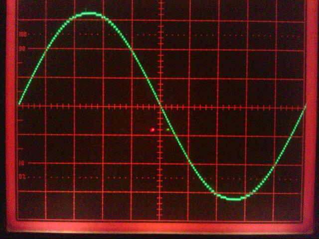

What it looks like on a real oscilloscope with just a 100:1 probe poked into a power point and the ground coming through the earthing of the oscilloscope frame.
There are 81 steps peak to peak, and this is the direct unfiltered output from the inverter.
I can run the house either off the inverter, or off any of the three phases.

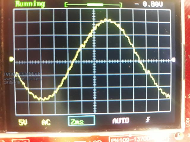

Thanks guys I worked it out.
Looks like the 2800w giandel PS inverter isn't so pure.
Would using this on household stuff root them?

My old Trace inverter looked like that, never caused any problem. I would be careful with the ride on dishwasher though.
