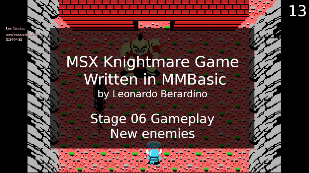

I released the stage 6 gameplay video.
https://youtu.be/TD_DWqn7wSA

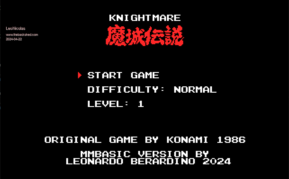

Hello everyone
I completed the game intro and main menu implementation. The next steps are to implement stages 07 and 8.
https://www.youtube.com/watch?v=xB08OaIKxmU

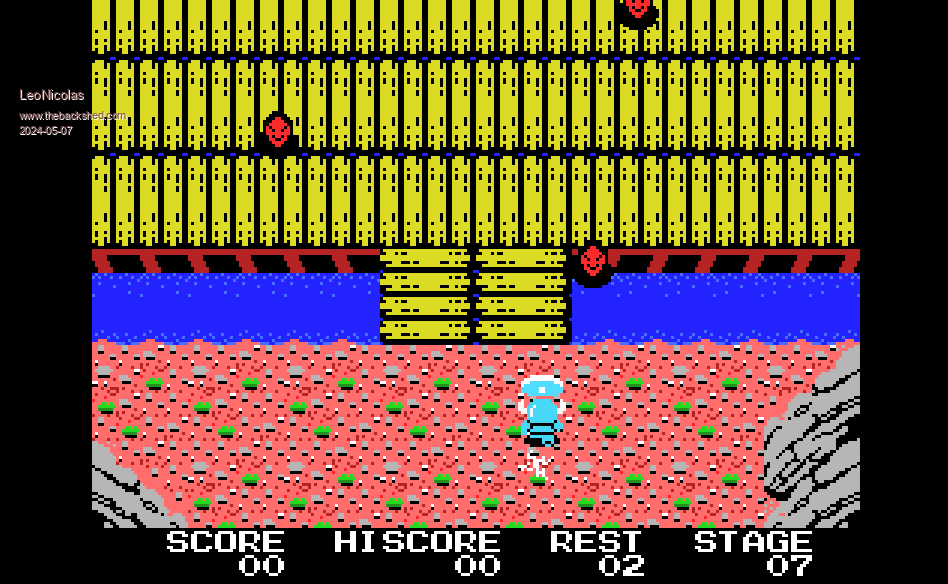

Posted: 02:25am 07 May 2024
Stage 7 is coming
