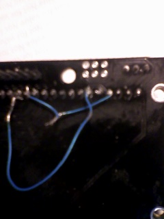

sparkey

well ok then is this correct...
donmck
Joined: 09/06/2011
Posts: 1314
Posted: 03:17pm 17 Nov 2011
  sparkey said   well ok then is this correct...
Sorry, not even close sparkey.
I have re-written the details to hopefully make it clearer.
Jumper DuimoMite PIN (13) to PIN 4 (RS) of the LCD header.
Jumper DuimoMite PIN (14) to PIN 6 (E) of the LCD header.
The DuinoMite (or Maximite) PIN is referenced to the software pin, and is shown on the picture below:
Cheers Don...
EDIT:
Just wondering what you would have made of this Sparkey? This is the full info I got from Ken on this mod, but I was able to sort it out.
if you don't mind 2 jumpers just move d8 and d9 to d2 and d3
Of course, I know Ken is looking at it from a software point of view, so he is talking about schematic signal names, not PIN(X) numbers, shield pin numbers, or LCD pin numbers.
Edited by donmck 2011-11-19
https://www.dontronics.com
